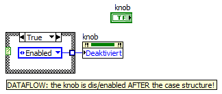

how to disable the knob after click a button?
You need to OBEY the DATAFLOW also in LabVIEW NXG: right now you disable the knob in parallel to your loop polling the button - but not "afterwards"…
And also enable back knob after re-click?
Set the button to enabled instead of disabled: use a shift register to store the current condition (like a boolean flag) and switch/invert that condition with each click…

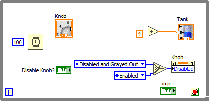

Hi bsang,
something like this:

Hi GerdW,
Thank you for the solution. I get the idea how to do. Btw the loop might a bit slow response after click Stop button. How can speed up the process time?
Message 7 of 12
(5,735 Views)
Hi bsang,
there is no wait function in your loops visible, so that VI will run as fast as possible.
No need to "speed up" anything here!
(You should think about using event structures to slow down that VI!)

Accepted by topic author KnightBS
@KnightBS wrote:
Hi GerdW,
You only need one while loop and no case structure.
