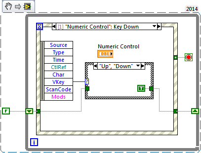

Hi Ramon,
no need to store a flag when you use a filter event (like "KeyDown?") and discard the event for "unwanted" keys:

@GerdW wrote:
Hi Ramon,
This is what I was trying to accomplish but couldn't get it to work as intended without the discard filter. I hadn't filtered anything before so I didn't know the option was available. Thanks everyone for the help!!
