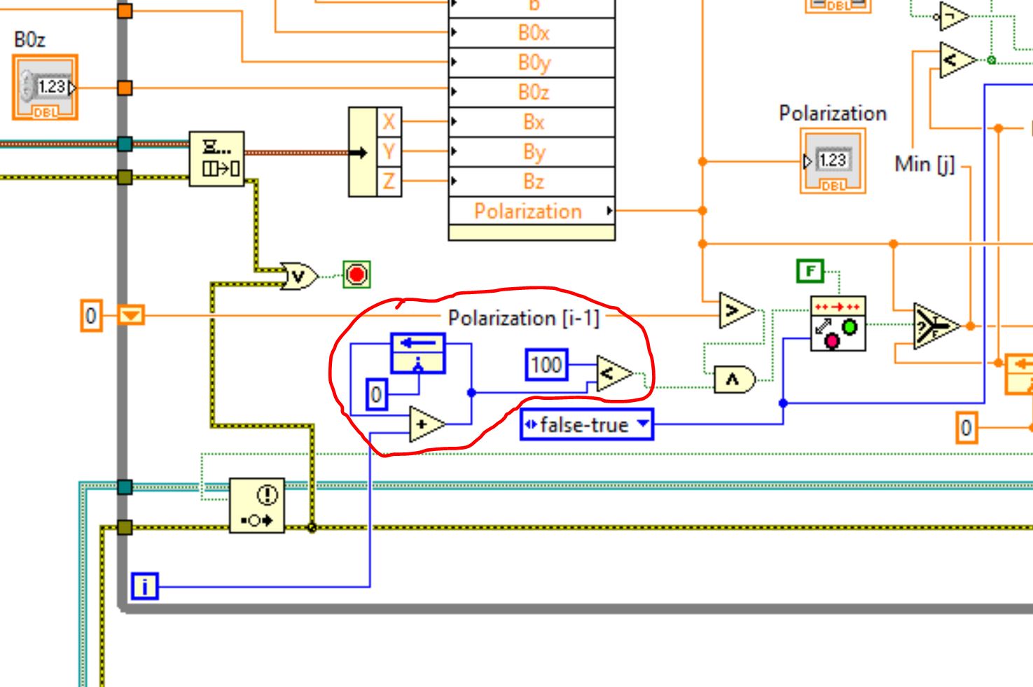

Disable connection upon VI start
Upon VI start undesired action occurs - value Polarization[i] is memorized in flip-flop (please, see the screenshot below).
Does exist some tecjnique, that allow to desactivate a connection (red cross on screenshot) during some instants upon VI start.
Thanks in advance
Pavel

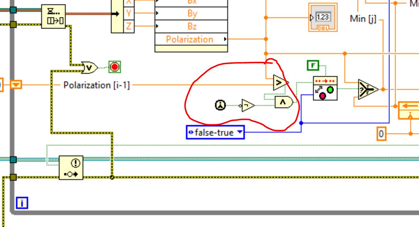

You can't disable a connection, but you can change the data depending on circumstances. There's a function called "First Call?" that you can use to manipulate that boolean. Maybe you want to value to be False if First Call? is true? Then put an operation like: If True and First Call Not True.
You should also initialize that value in front of the loop anyways. If you set the initial value to "Inf", the Greater Than operator will always be false, right?
Cheers
Message 2 of 19
(6,982 Views)
Thanks James,
Thanks.
I've tried your suggestion - unfortunately flip-flop still actions due to a "glitch" upon VI start.

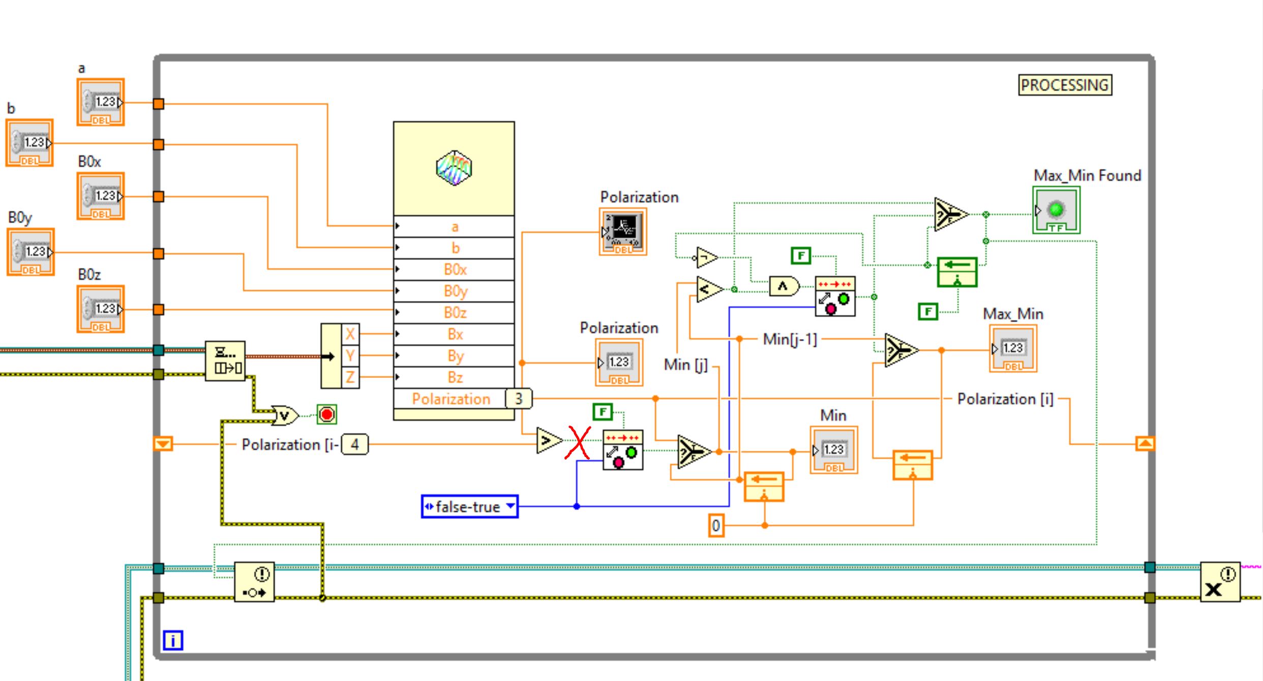

Apply the same logic as above somewhere else in your code to ignore the flip flop then. Like done graph point if first call. Or use a default value if first call.
Cheers
Message 4 of 19
(6,961 Views)
I've added 2nd condition (on comparator input), also added default value on SR.
Unfortunately problem persits

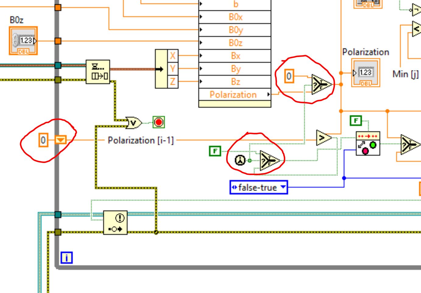

Well you're setting a default value of Zero to be graphed when first call... so you're going to see a value of zero on your graph. If you don't want to graph on first call, put a case strcture around your indicator terminal so that it is only written to when First Call is False.
Your Select function with the First Call value as the input and boolean as the output is redundant. Use a Not operator if you want to negate the value.
Cheers
Message 6 of 19
(6,944 Views)
I changed employment of the "First Call" according to your concept.
Concerning indicator, it isn't so important, the most important - prevent flip-flop memorize the value when VI starts as it's dramatically changes algorithm functionnality

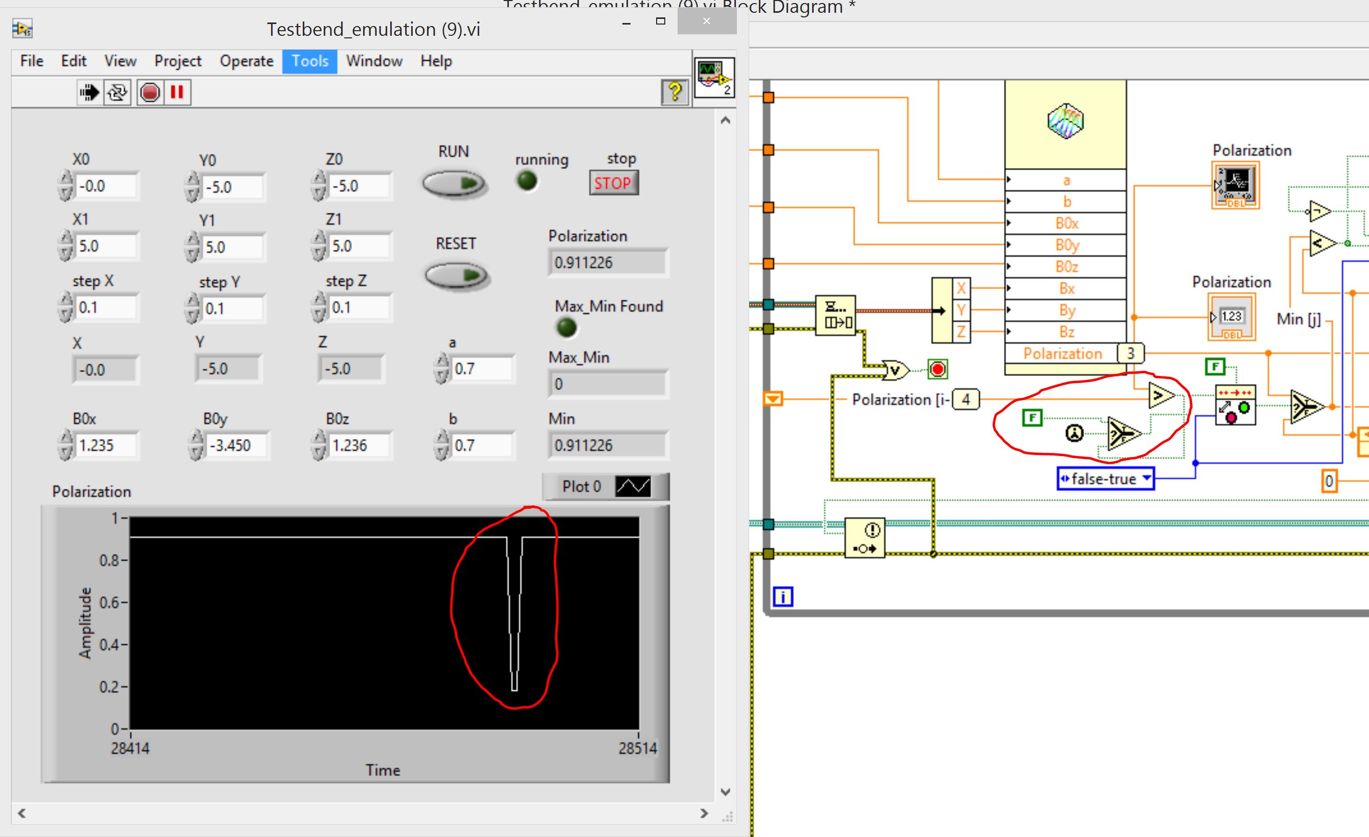

So what's your problem still? Do you need to put a case structure around that VI for the first call?
Pavel, remember, you have all of the tools you need to solve your problem. I think you're really lacking in the fundamental understand of how LabVIEW functions and its abilities. I've told you this before: I highly suggest you watch some free tutorials to better get your bearing.

Well, here is the solution that works.
Thanks.
Message 9 of 19
(6,904 Views)
Accepted by topic author Pavel_47
What the heck....? You're adding "i" to itself exponentially and comparing that to 100... So every time, your code is going to look like this:
0 + 0 = 0 < 100
0 + 1 = 1 < 100
1 + 2 = 3 < 100
3 + 3 = 6 < 100
6 + 4 = 10 < 100
10 + 5 = 15 < 100
15 + 6 = 21 < 100
21 + 7 = 28 < 100
28 + 8 = 36 < 100
91 + 14 = 105 > 100
This is rediculously round-about. If this reeeaaally works for you, just set the logic to "AND i > 13"
