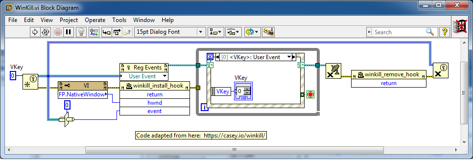

Quick example to show the WinKill usage.  I have adapted the code a little to remove the name mangling and to post a user event back to LV.  The windows callback function does not provide for user data so I had to get ugly and use a dll global variable.  The idea is simple:  create the hook and the user event,  do stuff (while loop), then remove the hook after the application is done.  Note, this disables the Windows keys for other applications, although you can still detect the presses (left or right).
Just unzip the attachment, open the VI and make sure it finds the dll parked next door in the same directory.

Interesting.
Could you please help to save the vi in LabVIEW 2013?
Message 5 of 8
(6,025 Views)
Accepted by topic author Sable
Added LV2013 version to the zip archive.
