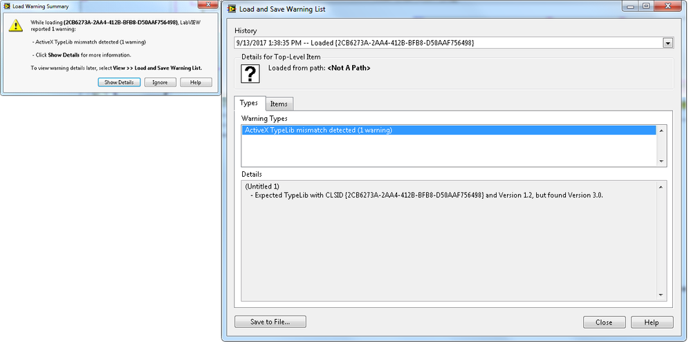

Did some more digging. By chance an invoke node was copied and pasted to another block diagram and we got these errors. Looks like the property nodes themselves are still coupled to an old version of the library that we upgraded at some point. Even after we relink and the methods/properties "reappear" the copy and paste still shows this error. The only way we can find to get rid of this problem, even after rewiring up a reference to the node itself, is to physically delete and recreate the node.

That sound a lot like the situation we see when we move from a machine with an old version of Office to a machine with a new version of Office. I had to find all fo the methods and invoke nodes and reselect what was being accessed.
I wrote it off as being a change to the ActiveX implementation.
So if you had exactly the same version of the ActiveX driver installed on both machines... that issue should go away.
