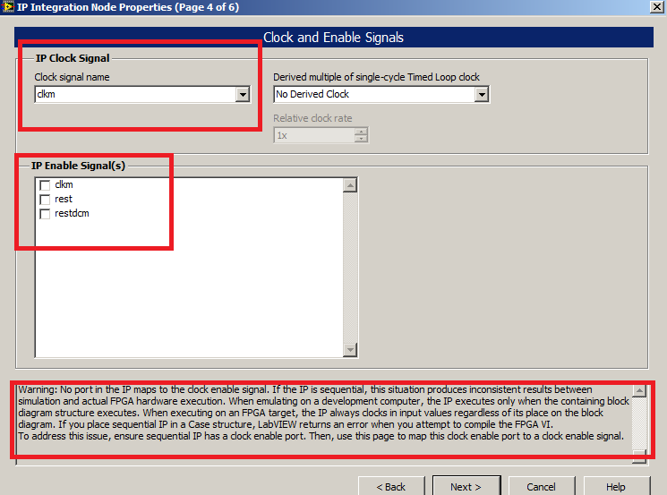

Well, did you notice the warning triangle in the logo of the IP Integration Node? That is the sign of possibly not having consistent result between your simulation and your hardware running. This is because your vhdl doesn't have any clock enable signal and thus your IP Integration Node starts to run before the other nodes on the diagram "wake up" (The other nodes are freezed by the clock enable.)
This warning of possible different behavior is shown on the page of enable signal selection of the IP Integration Node wizard. You can jump in there and have a close look.

so during IP block configuration for my system we can see the warring appear as shown in figure below
so dear what is mean by clock enable signal??? Can your modified the vhdl code for counter code to have clock enable???

For this specific case, you can modify your code to be something like this:
 process(clk,rest)
 begin
     if(rest='1') then
         coun:=0;
     elsif( rising_edge(clk) ) then
         if cClockEnable='1' then
             coun:=coun+1;
         end if;
     end if;
end process;
