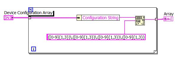

On second thought, here's mine

The function you need to use is Match Regular Expression, not Match Pattern.
Message 8 of 9
(8,370 Views)
Yep, thank you sir!
