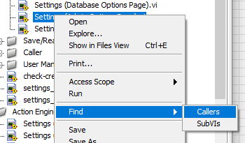

If your VI used by only one project, you can find all callers from context menu

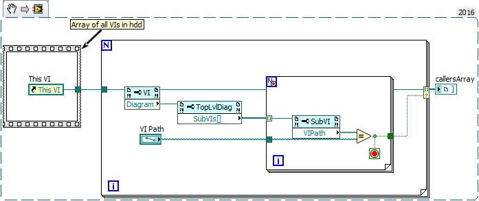

If you have many projects, you can use script. Here is a draft

That won't find subVIs inside structures.

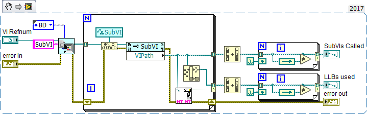

Maybe you're looking for something like this:
