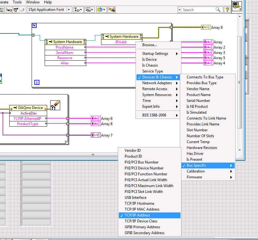

I also figued out what was wrong with your Find Hardware example.  There is evidently 2 IP address property nodes.  One for NICs and one for devices.  You want this one.
Message 6 of 11
