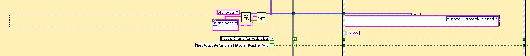

I have noticed that when I use a queued message handler where the queue element is comprised of an enum and a variant bundled together, updating the enum while the code grows in complexity has the nasty secondary effect that ALL queue element cluster constants (typically there is one per Event Structure Case, but sometimes more) grow a tiny bit each time.
After a while, I typically get this:
(My screen is 2048 pixel wide)

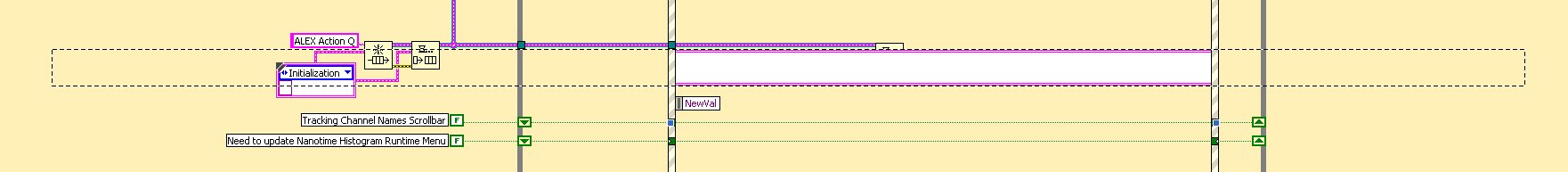

After some horizontal translation of the cluster (to be repeated for each case), I get this:

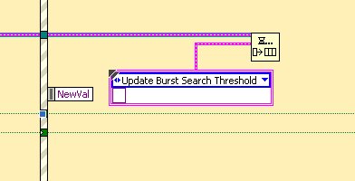

and after further tedious gymnastics, that:
This is what I should have had in the first place and this should NEVER change if I update the typedef enum I use to define my different actions.
Right now, I know I will have to fix this case later on if I add a few more elements to the enum...
I tried left justifying, right justifying, aligning the enum and the variant vertically, etc, to no avail.
That's truly an annoying bug.
