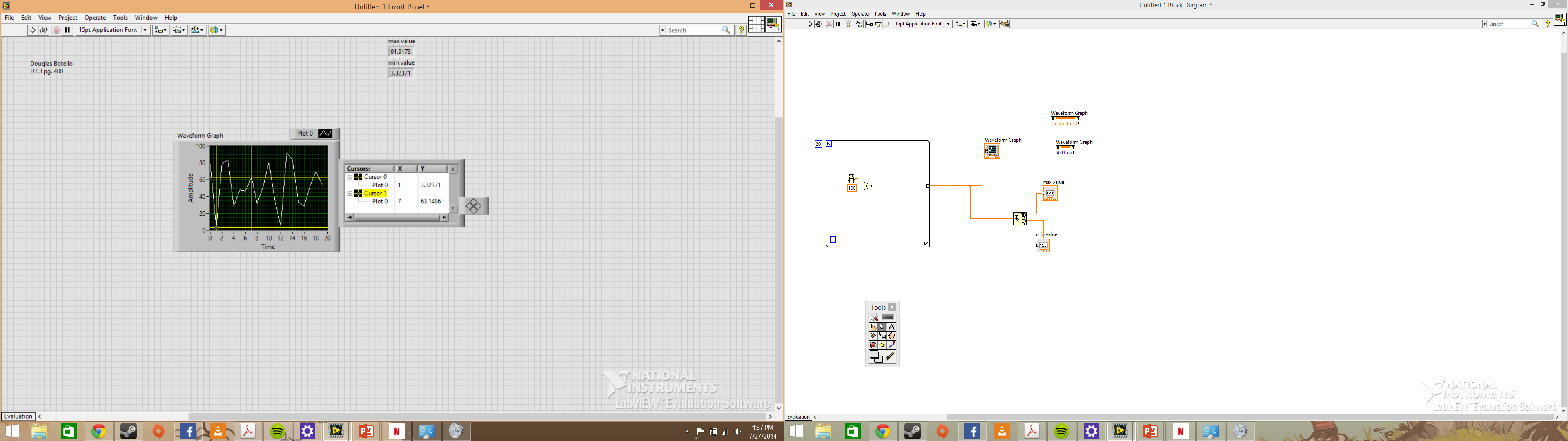

Here is my front panel and block diagram:

You are very close.  All you need to do is create a property node for the graph.  The first property you need is Active Cursor.  This is how you tell which cursor you want to affect.  The second property you need is Cursor.Position X.  So if you set the Active Cursor to 0 and the X Position to the index of the max, you will move the cursor to the position of the maximum.  Now do the same with cursor 1 and the minimum.

Okay, im new to this, so I'm still having trouble. I'll show you what I have now in the screenshot. I still don't know how to set the active cursor to 0, or how to set the X position to the index of max. Do I wire values to these properties, or do i wire the properties to the graph somehow. I really don't know how to wire these at all.
Thanks for the help in advance.

The property node is expandable, so you can set more than one thing at a time.  So expand the property node to have four parts and find the four properties you need (Active Cursor, Cursor.Position X, Active Cursor, Cursor.Position X).  Right-click on the property node and select "Set All to Write".  Now you can set the properties instead of just reading.
