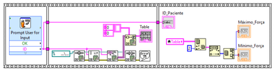

I changed my block diagram and put up a dial that says what the maximum force was. Through the table, can I ask the labview to read it and tell me what is the maximum value for each day and show those values in a graph?
Regards, Inês
