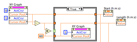

Fred,
I do not think you can prevent the user from dragging the cursors across each other. You can test for a minimum separation and force the cursor to a new position if the user drags it somewhere you do not want. This may be confusing to the user. An alternative is to use the cursor with the minimum value as the start position and just coerce Length to a 60 second minimum.
