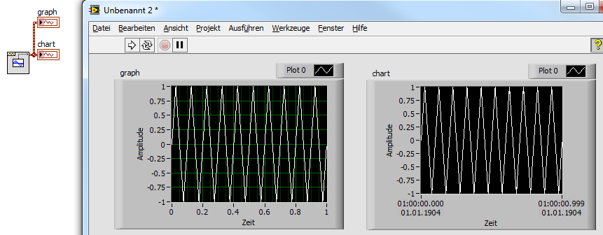

A simple example VI seems to work as intended:

Data is from a triangle wave in format of 1d array of waveform.
VI file is attached.
