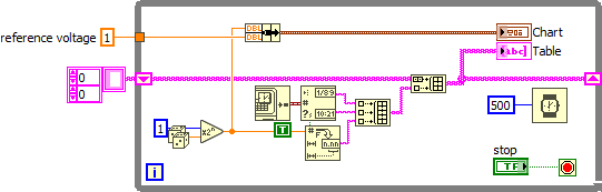

Here's q quick simulation draft using a table and a chart. Maybe it can give you some ideas....
Message 4 of 12
(1,063 Views)
Thanks for your reply.
But I got a bit confused when I tried running the VI you shared.
1. In my case, the data from VISA Read is still in string format, but the Waveform Chart needs data in double (DBL) format.
2. Also, the graph in your example uses time as the X-axis, but in my project, I want the X-axis to show cell numbers instead.
As far as I know, Waveform Charts only support time on the X-axis, which is why I decided to use an XY Graph.
Sorry if I misunderstood something. I’m still new to LabVIEW and currently learning to get the hang of it.
Message 5 of 12
(1,048 Views)
Hi Me,
  1. Then you can convert that string into a DBL float value. In your VI you converted to an integer…
  2. You can use a waveform graph instead as it supports plots with same X distance between points - no need for a XY graph…
    (Charts can show "time" on their X axis, but mainly support only "counting up" the number of points in the plot.)
LabVIEW comes with a huge example library, and there are example VIs for charts and graphs…
Message 6 of 12
