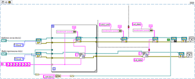

Hello! I'm facing the same issue the thread author did.
In my case Word report is saved and closed just as it's supposed to after the required data was added in. After it's closed it still takes 20 to 25 seconds for program to finish. I have no idea what could be the cause for this.
Any ideas are welcome. Thanks!

I have something to add. I just built up an EXE from VI.
First I ran it on the machine where LabView is installed and there was the same huge delay in the end of the program.
Then I tried the same EXE on another machine with no LabView installed and it worked smoothly as it should.
There is a difference in MS Office versions (2019 vs 2016). Maybe that is the reason. It works fine on the machine with 2016 version.
