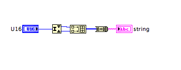

Danny,
Look at the Data Manipulation and Conversion sections of the Numeric Palette. Split Number and Byte Array to String are your friends.
As for the files, you will need to know the file formats. I never heard of either of those and a search at FILExt did not produce anything useful.

LKS = NI Lookout source, for HMI's/SCADA.  L4T's the state file.
Like johnsold said, split the number and convert to string.

@Dennis_Knutson wrote:
Use the Split Number function on the Numeric>Data Manipulation palette. Then do a Type Cast (same palette).
@johnsold wrote:
Danny,
Type Cast Man is worried about carpal tunnel syndrome from dropping too many primitives.
