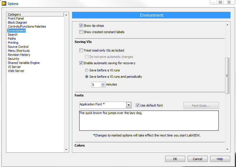

I have seen similar things with big Excel documents and "auto save" when a directory has a lot of files. As it's saving in the background Excel freezes up.
My development computer takes over a minute to refresh the My Documents or Pictures directory because I have well over a decade of documents and pictures that I have been dragging along with me from computer to computer.
It is possible that your first autosave is taking a long time but every save after that does not take as long because Windows has cached the directory contents.
Try disabling autosave and see if it changes
