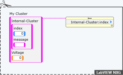

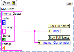

Do LabVIEW NXG cluster property nodes support fully qualified names as do the LabVIEW Classic unbundle nodes?
I always used the full names in LabVIEW unbundle nodes, but I don't see that option in NXG. If I use a cluster TypeDef twice inside a cluster I have to unbundle it in two steps to know what I'm accessing. This seems like a step backward if displaying fully qualified names is not supported.

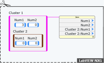

Do you want to show the full names on NXG?
I see the behavior but, do I have any misunderstanding?
Yes, I couldn't find "Hide/Show Full Names" options on NXG.

Okay, now I am seeing that behavior too. But I swear that yesterday I was getting the short names, and I could not find a switch for it. I do not know what changed. Is there a switch somewhere?
David Grucza, CLD
Message 5 of 13
(4,026 Views)
