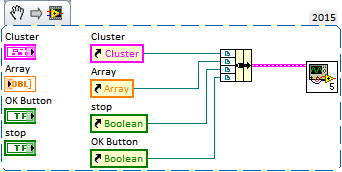

1. If there are some controls in the front panel, and I create a lot of control reference in the block panel, should I close the control references after I've used them?
I think it is not necessary to do it since I've never seen someone did it.

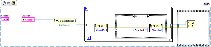

2. If I get the control references from the elements inside the cluster or other controls, should I close the control references after I've used them?
I think it is not necessary to do it, but I see someone did it...
3. If I pass the control reference to a subVI, should I close the control references inside the subVI after I've used them?

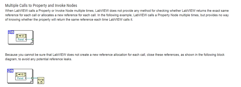

For more details: Closing References in LabVIEW

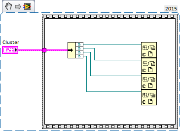

Question for the OP:
Why are all of your Close References inside a single pane Flat Sequence?
=== Engineer Ambiguously ===

Hi RTSLVU,
I'd just like to emphasize "the action of close reference"...
I'm sorry to make you confused, maybe I should use decoration instead 😂

It's not confusing, it's redundant... or rather superfluous.
Think about the data flow.
And yes you should use a decoration for emphasis not a programming structure

Hi billko
Very thanks for your reply.
I've seen many students and engineers put "close reference" for the control references(especially like the second case of my original post) or object references(like panel, pane, decoration, ...).
That confuses me for a long time 🤔
By the way, one of paragraph from the link crossrulz shared also confuses me a little:
I thought the panel reference array is not necessary to be closed manually, the elements of the reference array should be the same...

Hi crossrulz,
Very thanks your help!
There is a paragraph, however, confused me a little.
It said reference leak happened to control reference as well.
I hardly imagine how to make it come true.
I have two question:
1.
I thought reference memory leak happened when LabVIEW loses the access of the reference and has no chance to close it anymore or when the references is populating unintentionally.
For control reference, LabVIEW handles it totally, it can close it absolutely.
And the control references may be distributed in the VIs in a project, they are static and determined, is it not possible to populate unintentionally?
2.
If the reference memory leak still happened, does the increased memory just come from the new RefNums, not the related data?
For example, if there is an array occupied with 100MB, and the control reference of that array leaks, Is the memory leak like this way: 100MB + 2 byte + 2 byte + 2 byte + ...(a RefNum occupies 2 byte memory)

This the opposite of what you're thinking.  This is actually very thought-provoking.
