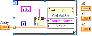

Just do like this:

@thols wrote:
Just do like this:
But don't complain that it is dead slow! 😁

@rolfk wrote:
@thols wrote:
Just do like this:
Still 1000x times faster than doing it manually 😎

Thanks, it is working. It is fast for my application.
