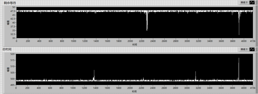

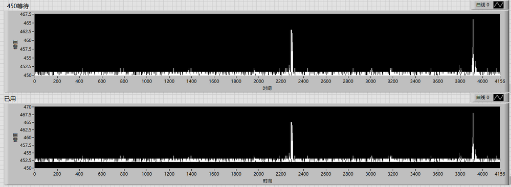

In order to test the accuracy of the time, I added a sequence structure to both of the whole module and waiting notification, calculated the time by subtracting from the time counter, and displayed the time by the waveform chart. It turns out that the time accuracy is a bit off. The timeout for waiting for notification is set to 450, but in fact it may exceed 10ms+, and the waiting function will also have an error of about 10ms. And the results are not the same with the two computers.

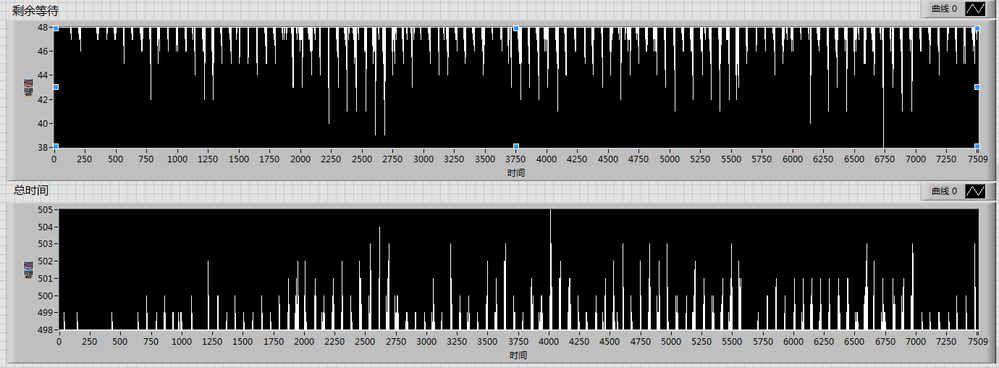

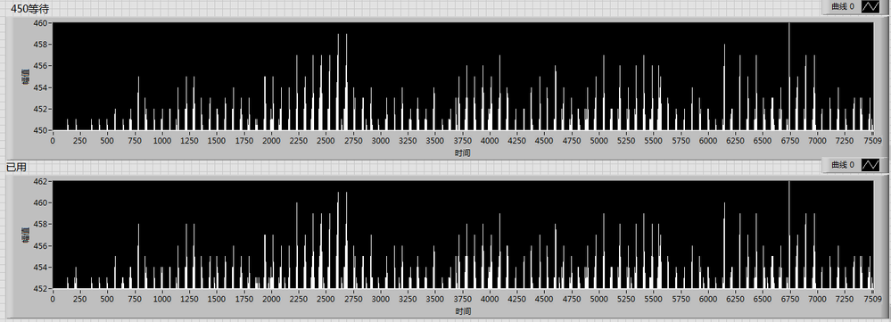

The first wave chart shows the time waiting notifications, set at 450, but the highest at 466.The third waveform chart is the last waiting function time, which is dynamically adjusted according to the second chart to control the whole process to 498ms.The fourth waveform chart shows the time consuming of the whole process. According to the theory, the final time consuming should be 498ms after the dynamic adjustment of the waiting function, but the final error feels a little too large.In addition, this is me running the same program on another computer, and the results are still different.
