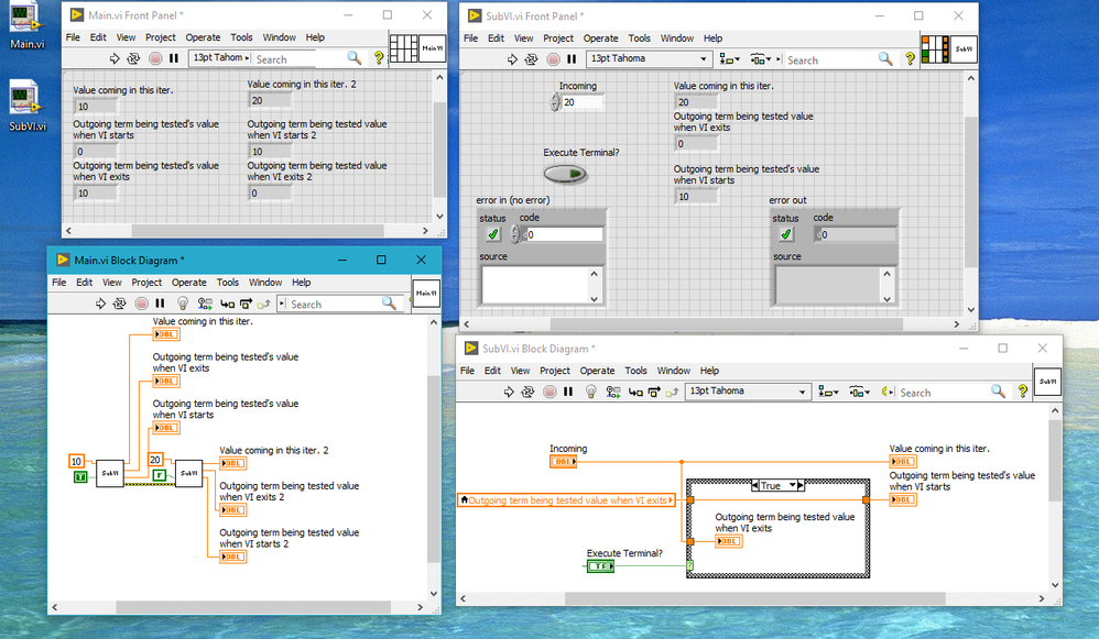

It never asked how the data in the indicator was being accessed.  Mine code wasn't to demonstrate a race condition, it was just to show that the value that existed on output indicator still existed in memory the next time the subVI is called.  The indicator that is being tested in mine is Output Indicator.  The "output before new value" is just a way to show what value was in the output indicator before it got overwritten again.
Christian, your VI is changing it up and testing the "in case structure" side of things and is making "outgoing before new value" the indicator you are testing.  It is demonstrating the dangers of having an indicator in a case structure, and is the more important takeaway out of this whole conversation.  But the original question was about is value is still in memory in a indicator after the call.  Mine proves it is.  Though the answer is kind of meaningless because nobody should be using an indicator as a memory storage location.  You've answered the question that the value does not exist in memory after the 2nd call, IF the indicator terminal is not executed, only then does it get reset to default.
See below where I show a combination of the question that I see being asked, and also the more important concept you are demonstrating.  It shows that the outgoing value's terminal is retained between calls.  The outgoing value of 10 still exists when the subVI is called again.  But if the terminal is not executed, then that terminal's value is reset to default upon exit.

So to wrap up with an answer to the original question:
"A subVI will always retain output/indicator values in memory after each call, until LabVIEW is closed.
Is this correct?"
The answer would be yes/no, it depends.   Yes, unless the terminal is in a case that does not execute, in that situation the value is lost AFTER that instance of the subVI exits and where it is returned to its default value.
