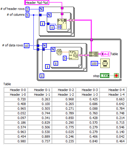

Tables are just 2D arrays of strings. You have full control on what's in any of the cells. No need to even use the headers. You can even create multiline cells.
Message 2 of 8
(2,381 Views)
Accepted by topic author GRCK5000
Quick example:
You can easily change the font style and background color of the headers (or any cell you like)

Thanks a lot Mr. Altenbach. As soon as you told me that a table is nothing but a 2D array. I worked hard and I was able to accomplish what I wanted. Your codes are so insane. I have a very very long way to go to get on your level. Thank you very much!

That solution will work well enough if you don't need to scroll your table.  If you do you can either try to use the property nodes to read what the top left cell is, and then set the values based on that, and any cell background color.
Or you can use the normal column headers, but have multiple rows of text in each cell.  I couldn't get to setting the column values from the front panel.  But using property nodes I could make multiple rows of text for a Table or a Multicolumn Listbox and it would display it properly.

Also, if the headers are truly static, you could even use the caption. 😄
