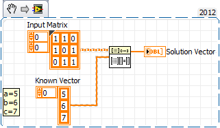

You have a known matrix, a known vector, and a vector you need to solve for given the equation Ax = b.  This is exactly the problem this VI is designed to solve:
With the values I made up for a, b, and c, the solution is [2, 3, 4].
