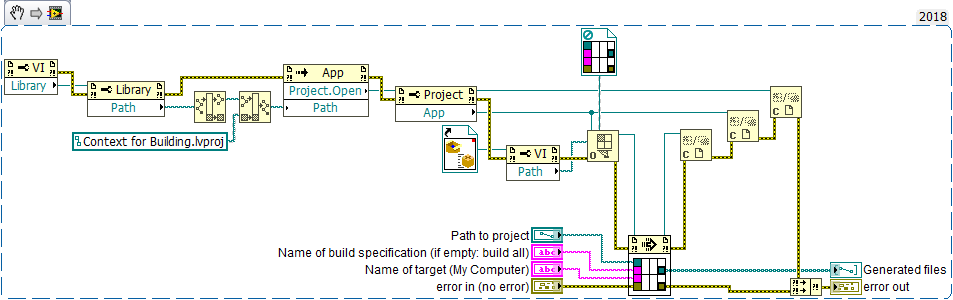

My wild guess is that there's a hidden dialog box waiting to be dismissed.  It might have something to do with the context that the builder is running in.  Try something like this:

You called it correctly. Your suggestion made me try running the installer build by hand as it were. A pop-up window came up telling me some files in the cache required admin privileges to access. I had never seen this before. It is not surprising the build failed, but that is a nasty way to fail.
I will try your context code to see if the pop-up shows there as well. That at least would give the operator a chance to fix the problem.
