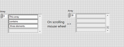

I've an array control with some number of elements. When I scroll on array control, the vertical scroll bar keep on going and displaying the empty elements in the array. Is there any property available through which I can control the movement of scroll bar?
Attached image for reference.

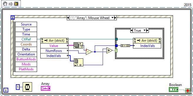

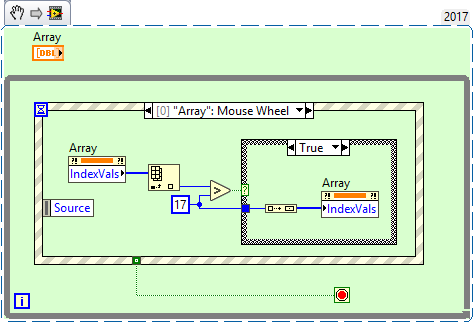

If your LV version supports the Mouse Wheel event, you can hook this event and correct the IndexVals property

I Was thinking along same lines.

But I was a little bit lazier Smiley Happy

Thanks everyone.. This solution meets my requirement.
Thanks for your concern for flickering effect but it is not a big deal in my case 🙂
