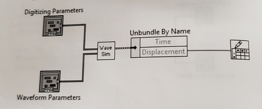

I have been working on example problem from the book ( Hands -On Introduction Labview for scientist and engineers by John Essick). I have created the math script to generate the sinewave and other types of user difened wave using ENUM.
the Program works fine as follow.
For 2nd step u need to open new VI and store the data in spreadsheet file.
as follow given in the book
Problem : Whenever I try to do that. it show the following error
I have attached the following file too
1. Waveform subvi (Imported into the new one)
2. VI having error in storing the data

Do you mean you have a question about arrays?  Doubt mean you don't believe they exist.
Your problem is you are using unbundle by Name.  But in your subVI, your arrays don't have a name, so when you bundle them, you don't have a way of referencing them.
You have a couple options.
1.  Use Unbundle instead of Unbundle by Name.
2.  In your subVI, show the labels on the two arrays you have in  your cluster indicator and give each one of them a name.

thanks
Unbundle works but still I cant see the name there.
But i can see the file save.
Did you really name the cluster elements as suggested.

@skdubey wrote:
thanks
thanks
Then I "doubt" you did what I said.
Did you give names to the arrays inside the cluster inside the subVI?

yes i did!

Could it be you named the array elements instead of the two arrays (inside the cluster)
