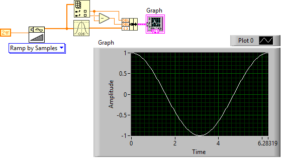

Here is a typical way to use an x-ramp and get x0,dx from it while also calculating the cosine function. Now the graph x-axis is correct even if you change the ramp (start, end, number of points etc.). No FOR loop needed.
