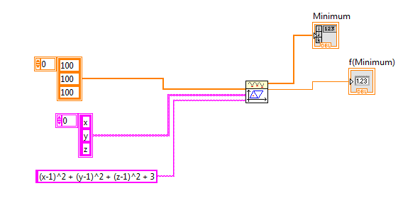

fzhong,
If I am understanding your concern correctly, the code below should use the Downhill Simplex nD VI correctly with the equation you want:
If you need the equation to be dynamic, you can always dynamically create the string and array of strings for the equation and variable names, respectively, and feed them into here as well.
If this isn't what you are looking for and you still need some help, please post more details, and we will see what we can do for you.
