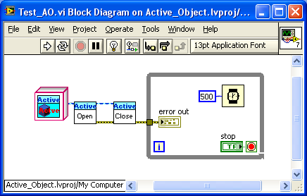

Like I said I'd look into this, BUT before I let myself cheat by looking at the posted code I forced myself to do one of my own*.
In the proces I ran into bit of a problem that may be another manifestation of Dr. Damien's point #3.
Here is my personal challange
Create a generic Active Object Class that had all of the functions required to manage and interact with an unknown number and clients.
1) For the time being a Tester.VI executes an Open operation (method).
2) The Open Launches a template as shown below. Note: Setting the "Class" control using the method "Ctrl Val.Set" lets me choose the personality of the
server I am creating.
3) The template itself is is a simple and (latter hopefully) robust generic server that once intitalized, performs some function and responds to commands (methods) invoked by one or more clients. Since it only uses Dynamic dispatched VIs, Children of this class will be able to over-ride any or all of the states as required.
Challenge!
Create a set of queues that allow two process to communicate with out knowing the connection at development time.
I wanted two queues, one to send commands (methods, like Start Stop Pause...) and another to reports status and respond to commands (methods like Paused, Running, Error_Exit) as well as return responses from commands. The other thing I wanted to support was to have multiple clients supported by the Server so that I could develop Server Classes (childern of what I am working on) that could serve a serial DAQ device (I use a design based on Bruce Chubb's design from the late 70's).
This presented a little bit of a challenge. Unlike the Command queue which would be emptied by a single VI (in this case the Template), the multiple
clients should each have their own Response Queue so the right reply gets back to the person (client) who asked.
This post will be continued in the next post
