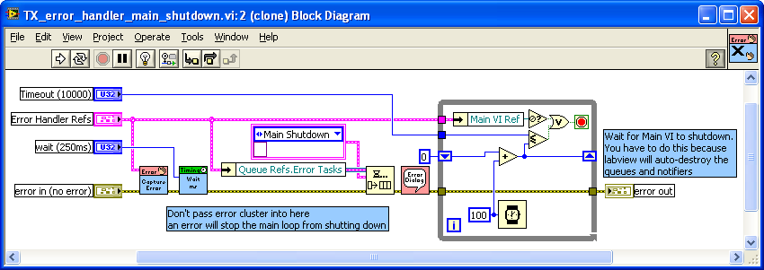

3) When the parent VI stops, the server.vi is automatically terminated due to the way the VI ref is handled. To make sure that server.vi finishes processing its tasks, watch for its reference to go invalid before continuing.(as shown below)
