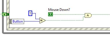

if you to the handler of "Mouse Down" event you can add a condition to set the "Mouse Down?" boolean only when left button is clicked. Something like this:
In this case when you right click the program will not go into the "True" case of "Mouse Leave" handler and display the right click menu properly.

I didn't see that one.
Thanks a lot
