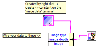

Hi Gunter,
To address your final question in your last post - if you right click the terminal and 'create -> constant' this will create a cluster with the correct typedef (even if it is a LabVIEW built-in typedef or otherwise) - which is basically what nathand suggested (having read it after posting!). You can then use that as the input to the 'bundle by name' node and wire in your elements to that.
See image below:
(blog)
Message 6 of 9
(4,857 Views)
gmhgmh wrote:
What I can't find any information about is how to cluster raw data into a predefined labview typedef, in this case "imagedata". For example if I use "cluster by name" and make all the inputs to the block those required by imagedata, will Labview magically know that this is an imagedata typedef? (If so where can I find the exact names required for the typedef?)
The approach demonstrated by Sam_Sharp is easiest. However, for the sake of completeness: you can wire clusters containing compatible data together. You don't need to match the names of the cluster elements; all that needs to match is the data types and order. If LabVIEW can coerce the data to the correct format, then it will let you wire the cluster to the terminal, although it might show a small dot (a "coercion dot") indicating that the types do not match precisely. Normally you can ignore that dot, especially when it's just coercing a non-typedef to a typedef that are otherwise identical. If LabVIEW cannot coerce the data, then you get a broken wire. LabVIEW don't need to "magically know" that it's image data, it just needs data that matches the expected type.

Thanks again everyone.
Is there some order in which I have to draw the blocks as shown by Sam_Sharp? No matter what I try I get unconnected wire errors.
(But I have things working with draw unflattened pixmap which didn't need a structure.)
Thanks again,
Gunter
Message 8 of 9
(4,819 Views)
If you just have bits of a wire dangling off somewhere unconnected but everything else is right, delete that unnecessary wire section (I'm not quite sure why LabVIEW doesn't do this automatically). It shouldn't matter what order you do the operations in, although you need to put the Draw Flattened Pixmap in place first in order to be able to create a constant from one of its terminals. If you show a screenshot of your specific problem it will be easier to explain the error.
