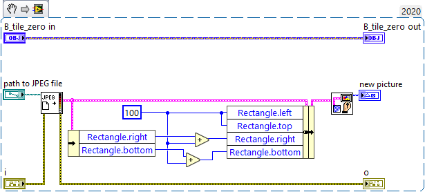

I know this post is old but I was looking for the same question in 2021. I figured out you can also set the image position in the picture by directly manipulating the image data / Rectangle, just make sure you keep the same aspect ratio and size or it will draw a funky picture. see code snipit.

To be fully correct you should actually also apply the offset to the left and top coordinates. While that is usually 0 and 0, it won't be once you do such funky offset manipulations. And it's even imaginable that an image has actually another than a 0, 0 origin. Image formats like PNG would support such things with optional Tags, although I'm not sure the LabVIEW PNG read function supports such things.
Rolf Kalbermatter  My Blog
Message 8 of 10
(5,073 Views)
Well I would never want to be fully correct on anything, I'm ok with technically correct ; )
