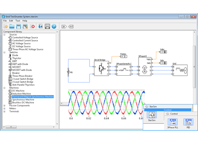

I would like to ask you what Control should I use if want to create a UserInterface like in VBAI State and Transition Editor:
or in StarSim:
Thank you for your help,

Looks like tree control on the left, picture control on the right. You'll have to customize buttons to get the effect of toolbar buttons, that are flat, but pop out when you over. You do this by customizing the system control buttons. I think that covers everything you see there.

Dear Greg,
Thank you for your valueable reply. Actually, I am focusing on the picture control too. I am wonderig about, what a great work behind this user interface solution in both cases.
I will look around in the Pictrue Control examples and VIsets.
