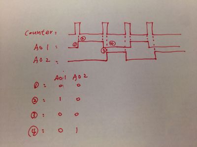

Hi, I wanted to generate signals on two analog outputs every time the counter output changes state (both rising edge and falling edge). The pic shows more details:
As you can see, there are four states on the two analog outputs: (0, 0), (1, 0), (0, 0), and (0, 1). The values repeat from the beginning every two counter raising signals, and whenever the counter changes state, the analog outputs would step through those values.
My counter output can generate two pulses when an external source comes in, and it is working well. What I haven't figured out is:
1. How to use the counter output as clock source for analog outputs.
2. How to generate a set of analog outputs one at a time whenever the clock edge changes.

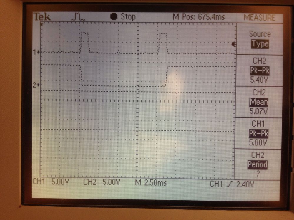

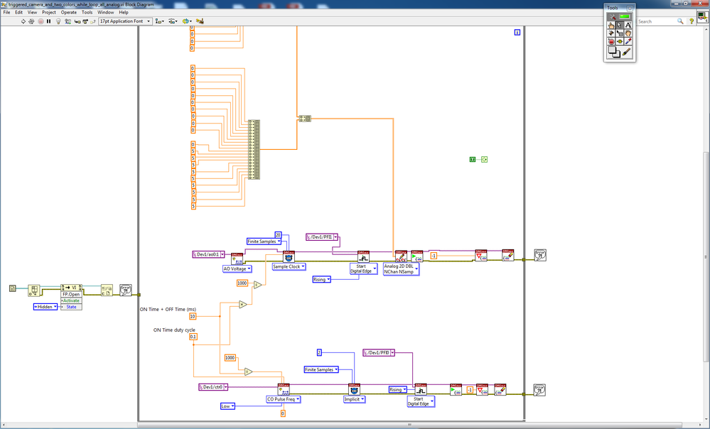

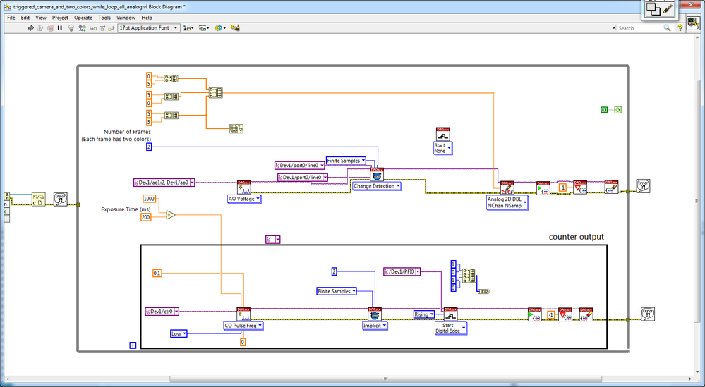

Kevin, I got it working by keeping the counter signal the way it was, and wiring counter output to PFI1, and make the AOs triggered by rising edges of PFI1. When AOs sees the first rising edge (there will be two, but AOs will be in the middle of outputting and thus ignore the 2nd one), they would output 20 predefined values in units of 1ms.
BTW I am using a PCI-6723.
Here is the final vi and a pic of signals from counter output and AO2.
