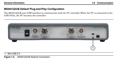

Hello, the driver you sent indicates that its interface is Ethernet, it also indicates that it is tested on the VNA MS46122B. However, this VNA does not have this port, how is it possible?
Message 8 of 10
(2,122 Views)
Slight language confusion here - Ethernet interface is referring to the network socket port opened for communication, not a physical Ethernet port/UTP cable port on the device.
I'll direct you to the ShockLine Series Programming Manual at:
https://www.anritsu.com/en-US/test-measurement/support/downloads/manuals/dwl18848
(link may become obsolete as new versions of the manual are released)
Specifically, Chapter "1-6 Communication":
Yes, the VNA only has an USB port connection, but as you connect that to a computer, said computer becomes the controller.
After connection, boot up the ShockLine software, and it will enable communcation at the IP of the host computer, on port 5001.
You can than use that Network (Ethernet) port to communicate to that device. If you're using the very computer the VNA is connected to in order to initiate communication, you can use the localhost 127.0.0.1 IP address.
Message 9 of 10
(2,034 Views)
Thanks for your answer, I was stuck in this confusion for a few days but I solved it, you are right in what you tell me, it was what I had to do to have communication with the PC. It should be noted that for the VNA MS46122B, only the raw socket works.
