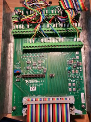

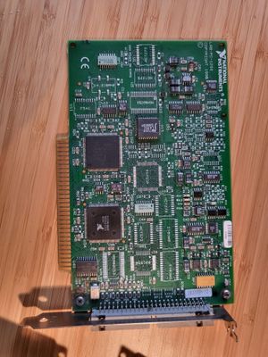

We have a Windwos 98 computer in use for minus temperature measurement. Unfortunately, the hard disk has gone.
However, we still have a faultless computer with an ISA connection which we could now use.
Now I am urgently looking for all the necessary drivers for the following products:
- Plug-in card LAB-PC-1200 (183010H-01)
- Eight-Channel RTD Signal Conditioning Accessory SC-2042-RTD
Thank you very much for your help.

Hello UliB
Thank you very much for the great help. This is exactly what I was looking for.
Message 8 of 8
