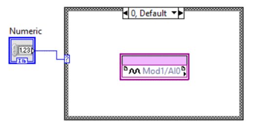

I would like to dynamically select which inputs are being used by the measurement, instead of hard coding which inputs to use.
Instead of having to make a case structure with every single possibility for 16 channels (65,535 possibilities) like this:
I would like to just specify on my PC application: Mod1/AIO, Mod1/AI3, Mod3/AI2, etc.
Is there some way to do this that I am overlooking besides coding 65,535 possibilities?

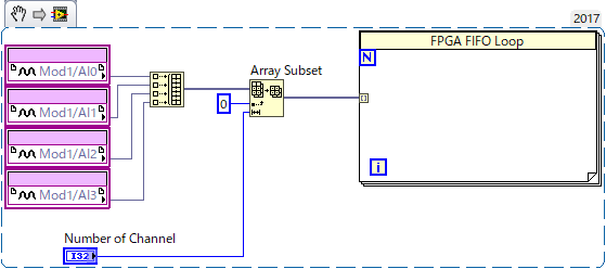

When I develop similar application, I don't use case structure.
Your idea is general but as you know, is troublesome. How about following code?
Anyway, in my general step, I place all IO node which would be required. I do an operation of the channels as array operation.

That would mean that I would still have to acquire all 16 channels every time. Also, I perform some computations based on the measurements taken, which I need to process in parallel for speed reasons, hence, I do not wish to join the different fixed-point values and then cycle through them all in an array serially.

I don't have a solution regarding the different fixed-point types (but why/how do you have these - you said two of the same module, no?) but you don't have to acquire all channels - you can (I think) use array subsets.
You cannot allow the references to be dynamic though - so you can't for example specify them from the host PC (again, AFAIK). They must be specified as BD constants (you also can't select by reference, which is annoying but I'm told a necessary requirement, see https://forums.ni.com/t5/LabVIEW-FPGA-Idea-Exchange/Selecting-between-two-I-O-refnums-not-allowed/id...).

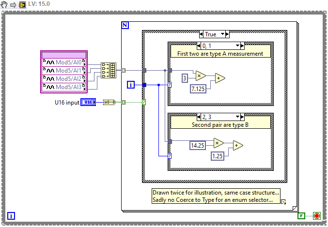

The FPGA is quite good at converting integer data into their bits so all you need is a U16 for selection:
On FPGA you also have the problem of "fixed-size arrays", so it becomes hard to change array size at runtime.
I also think it's easier (less FPGA fabric) to read all 16 IO nodes all the time and only process the samples you need…

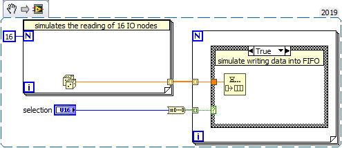

Following on from GerdW's post, you can also do the following:
