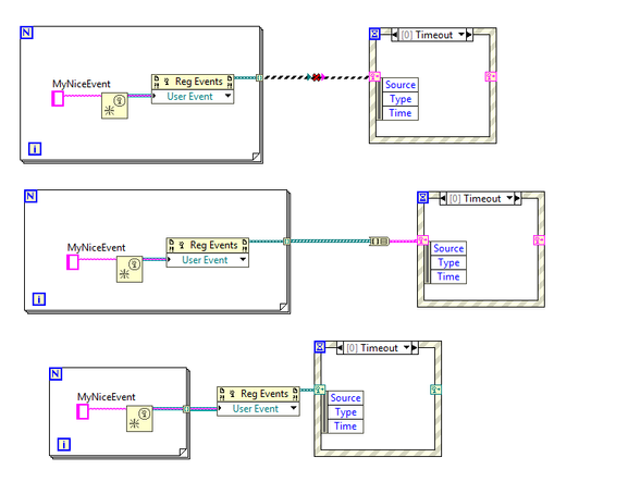

I have array of classes, class has generates user events, I want for user to be able to recieve those events but without direct access to event itself (he can not close or generate event)
It seems that it is not possible to directly connect array of event registration refnums to event structure.
Another approach would be to convert array to cluster but that requires knowing array size ahead.

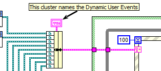

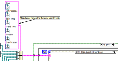

If the number of events is known at edit time, which to Paul's point it must be, then you can at least name the events for the purpose of labeling the event structure consistently like this:
to get something like this:
