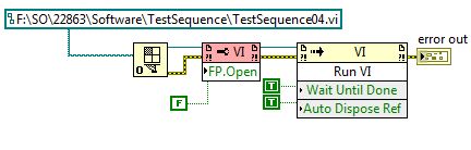

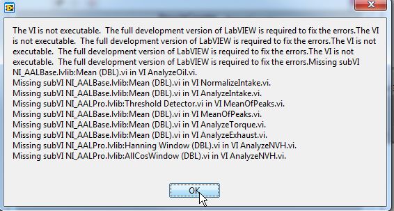

Below is sample code and an error I get in 2013 for VIs that will not load even though I have these in the .exe file. Anyone know a way around this?

Do any of the VI’s you’re calling use any .NET calls?  Sometimes this error message will appear if you do not have the correct version of the .NET Framework installed on the target machine.
Additionally, it is worth checking that you are placing these dynamically loaded VI’s in the correct file path.  Take a look at the following two KnowledgeBase Articles:
http://digital.ni.com/public.nsf/allkb/644C66077212FC218625760F004C6733?OpenDocument
http://digital.ni.com/public.nsf/allkb/EEE8A5650DAC28558625762F0070A384?OpenDocument
The first article explains a couple techniques for dynamically calling VIs from an executable without including them in the executable.  At the end of the article it mentions that in LabVIEW 2009 and later, the file structure for executable applications has changed, which is explained in the second article mentioned above.

Thanks, Linsday. For now, using the LabVIEW 8.x file layout under the Advance Tab of the application properties solves the problem.
 Do you notice the Red appearance of the FP Property Node?  It's my understanding that this marks a "deprecated" feature, one that might not work any more.  Try using the Front Panel Invoke node instead and see if that fixes the problem.
(3,744 Views)
Thanks pointing out the depreciated property node, although it does still control the front panel, that is something else I need to search for when migrating older code to 2013. Normally that is not in there, just the open and invoke node. I added it (copied from older code) to leave the front panel open after the invoke from an exe so I could 'run' the broken vi to see what is was missiing. The real issue is the file paths as Linsday pointed out.
