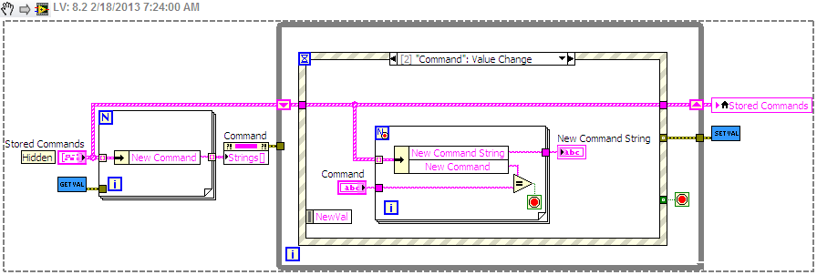

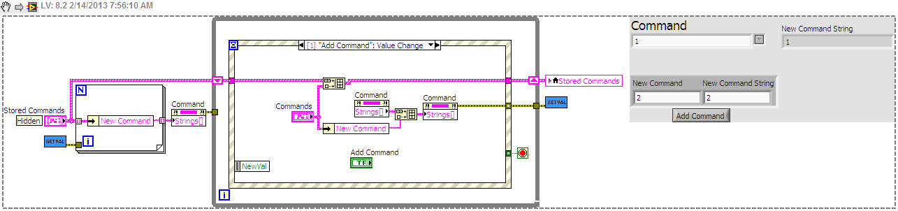

Darin shows how to use tags in a VI to save control values.  My example uses a Combo Box instead of your enum because, as you've noted, you can't dynamically add elements to an enum.  The blue sub-VIs are from Darin's post; you'll need to download them.  This works with a VI in the development environment; I think you're back to an ini file if it's built into an executable.

You won't be able to update any structure dynamically while the VI containing the structure is running.  My solution updated the array with any new command that you'd like to add.  You don't need a Case structure to get the command string; just loop through the array.

Yes.  My example shows how the new command string is found in the array.
