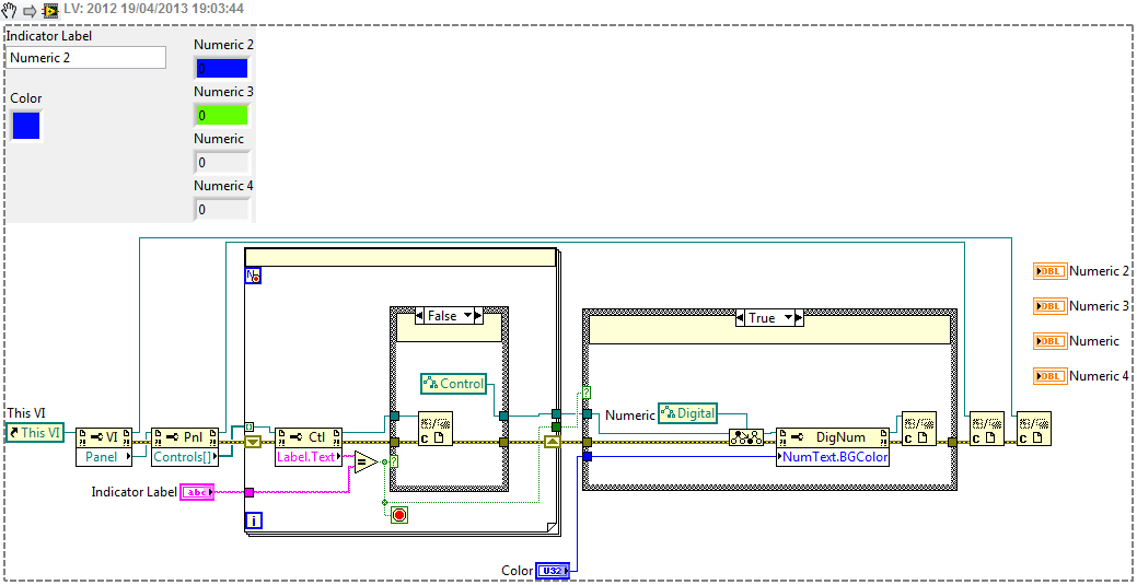

You can get an array of references to every control on a panel through a VI property node, then loop through every element of the array, checking if the control label matches the desired value, and if so return that control reference. I don't recommend this approach, though.
How are your 50+ indicators arranged? There might be a better way to present your data. For example, if they're in a table format, you can use a table indicator and set the text color and background color of each cell individually. Another option might be replacing your indicator with a cluster of 2 elements - a numeric control with a transparent background on top of a colorbox. You could then write a simple VI that takes a numeric input and calculates the appropriate background color for the colorbox, with a cluster output that you can wire directly to the cluster on the front panel.

As Nathan suggested, its not a good idea to have 50+ individual indicators unless there is a good reason for it. Here is the non-recommended approach.

It wouldn't take that long to rebuild, some of it isn't needed. You don't need the "This VI" reference, a VI property node will default to the current VI if the input isn't wired. Or, if you're going to turn it into a subVI, then the VI reference should be a control, not a constant. You do not need to close any of the references (although it's not a bad habit to do so). I would check whether the To More Specific cast is successful inside the for loop, and continue looping if it is not.
But this is still an inefficient way to handle the problem.

Here.

@.aCe. wrote:
Here.
.aCe.,
That code works well, but if the indicator is in a tab control, it doesn't find the indicator because it's in the tab control.  I watched the loop, it shows the tab contronl, but none of the contents of the tab control.  I think I am missing one more reference but cannot figure out which one.
