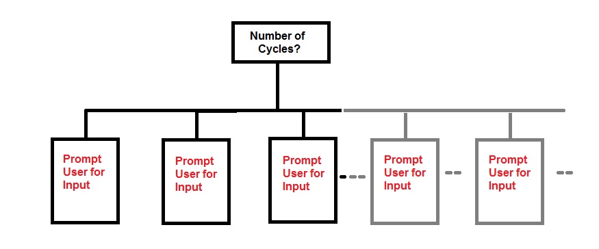

I was wondering whether we can do something more dynamic in Labview. I am quite new to LV, working on a project. My task is to make a test setup which will grow dynamically upon user request. whole scenario can be explained here.
Get input from user 'how many cycles do you want'?, upon user input number of prompt user dialogue boxes will grow. Let's say user enter 4, then 4 prompt user dialogue boxes should be opened one by one (which further contains 4-5 inputs), Each with different values (Which will further be used in another program).
I know use prompt user (And further making it typedef if needed). But don't know how we can expand or reduce number of dialogue boxes upon user request.

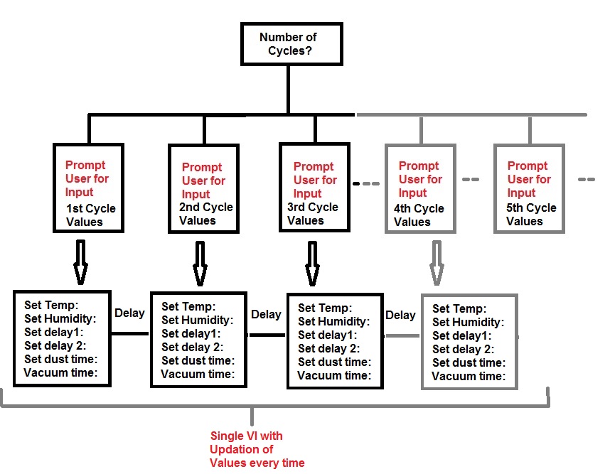

That's exactly i need to build which GerdW suggested but could not figure out how? I tried using ideas from both of you and end up with attached VI. But I could not save these values for further use. These individual prompt user values will be further used in a seperate VI as set point of serially connected devices and some delay elements. And yes, the cycles will run in series (One VI will get these inputs serially after one cycle will be finished). I am not sure i could explain it correctly or not. Here i tried to explain in a diagram, hope you will understand.

Bundle the data inside of the loop.  The output should be an array of clusters.  Now when you go to run the tests, you just use a FOR loop with an autoindexing input tunnel.  Inside that loop, you just unbundle the data.

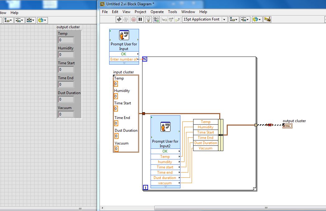

Dear Crossrulz,
I tried to implement it but got one error. I am new to LV that is why don't know much of the things. Can you guide me why this happening?
Thankyou so much.
Khan.
Message 8 of 14
(4,958 Views)
output cluster should be array.
-If you click on Broken wire and Ctrl+H you should be able to read why it is throwing error.
uday
Message 9 of 14
(4,951 Views)
Dear Udka,
Yes i can see error but don't know how to fix this. I tried to put array elements inside it but it does not work. Can you please elaborate.
