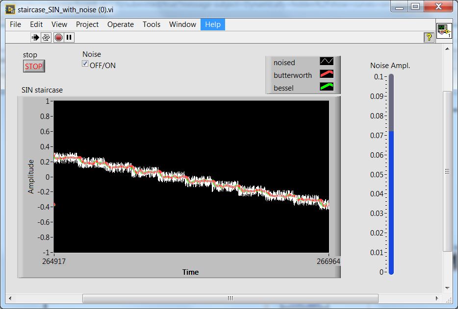

Is there some way to dynamically ON(OFF) a particular curve on WaveForm chart.
Here is example below - 3 curves are superposed and in order to see a particular curve it would be nice to have an option to OFF other curves (e.g. using checkbox).

each plot in a chart supports a "visible" property, so you can hide plots dynamically programatically.
In the plot legend you can also show a boolean button to show/hide the corresponding plot - atleast with LV2011 and newer…

This is actually a built in function.
Right click on the Plot Legend. Select Visible Items >> Plot Visibility Checkbox.
