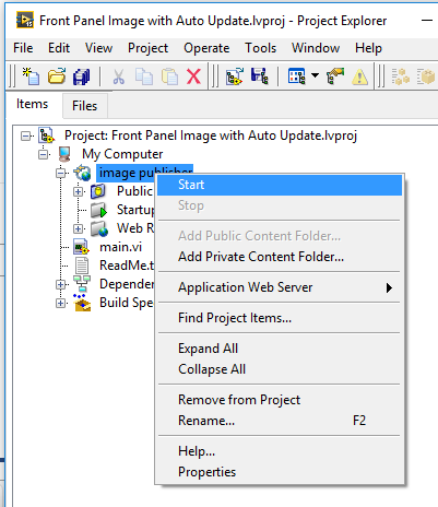

Steps to reproduce the crash (save all your files before you try this):
  1. unzip the attached project
  2. open project file
  3. Start "Image publisher" web service
  4. Run main.vi
  5. Stop the web service.
  6. LV crashes without error.

Hi Blokk!
An Upgrade to LV 2015 SP1 might help. Looks like your problem has been fixed (ID 542858)
