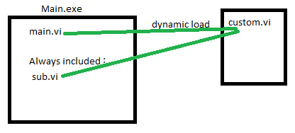

Dear community,
I'm trying to figure out how I could make custom libraries that my exe would load dynamically, and those external libraries could use as subVIs some VIs that are "included" in Main.exe
I made this simple diagram to show how I see it, perhaps someone already faced that issue and found some workaround technique to make it possible.
The idea is to keep Main.exe as standard as possible, without having to make a new build each time we make slight new features in custom.vi
Cheers!

Hi P@Anand,
my concern is only about the sub.vi that is no longer on the hard drive which results into a broken custom.vi
Main.exe contains sub.vi but also calls dynamically the actual custom.vi from a separated library on the hard-drive. custom.vi still looks for sub.vi but I'm just trying to figure how to reference it to main.exe available VIs in run-time.

Hi Hooovahh!
thanks for your answer, my problem is not to dynamically load a VI.
The thing I need to know is: custom.vi uses sub.vi which is inside Main.exe, how can we get it work?

You don't need to worry about it.  As was already stated, the version of the subVI that is currently in memory will be used.  If you don't believe me, give this a try.
I have a VI that calls subVI and another VI that is called dynamically that also calls the subVI.  The subVI just keeps track of how many times it was called.

That's cool if the VI is referenced somewhere in main.vi but if I modify your example by removing the direct call of sub.vi, it's not working anymore, even if I put it in "always included" list.
