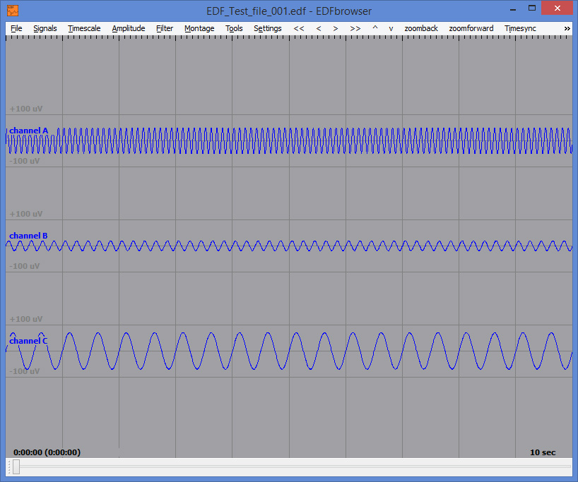

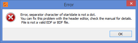

I have attached two VIs to explain the problem. The first VI, 'Waveform-array-to-EDF-file.vi', simulates three EEG channels and writes the data to an EDF file. The file is almost a valid EDF file, but it lacks a proper header because properties like 'EDF_PatientInfo' and 'EDF_Version' are not there.
You can 'repair' the EDF with the header editor from the free program 'EDFbrowser' (http://www.teuniz.net/edfbrowser/). Then you can read the EDF file just fine in EDFbrowser and other programs.

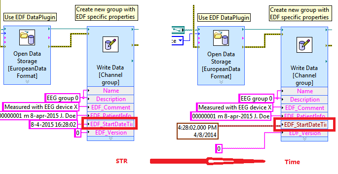

Hi Paul,
“EDF_StartDateTime” is Time type but not String type. The VI throws error out when wiring invalid type.
Making the following change should work.
(4,435 Views)
Hi Fuhuan,
That's it! I assumed 'EDF_StartDateTime' was a string datatype because you can read it as string when you open an .edf file in LabVIEW.
Thank you very much for you help.
Paul
