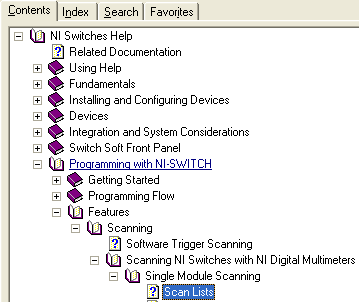

For the syntax on the scan list, please see the Switch Help file (Start » All Programs » National Instruments » NI-Switch » Documentation » NI Switches Help) and search for “scan list”.
Basically for pipe A, use one switch as chx->com and connect it to the DMM positive input and do the same thing for pipe B, but hook it to the negative input. The DMM will read the voltage potential between pipe A’s point and pipe B’s point.
